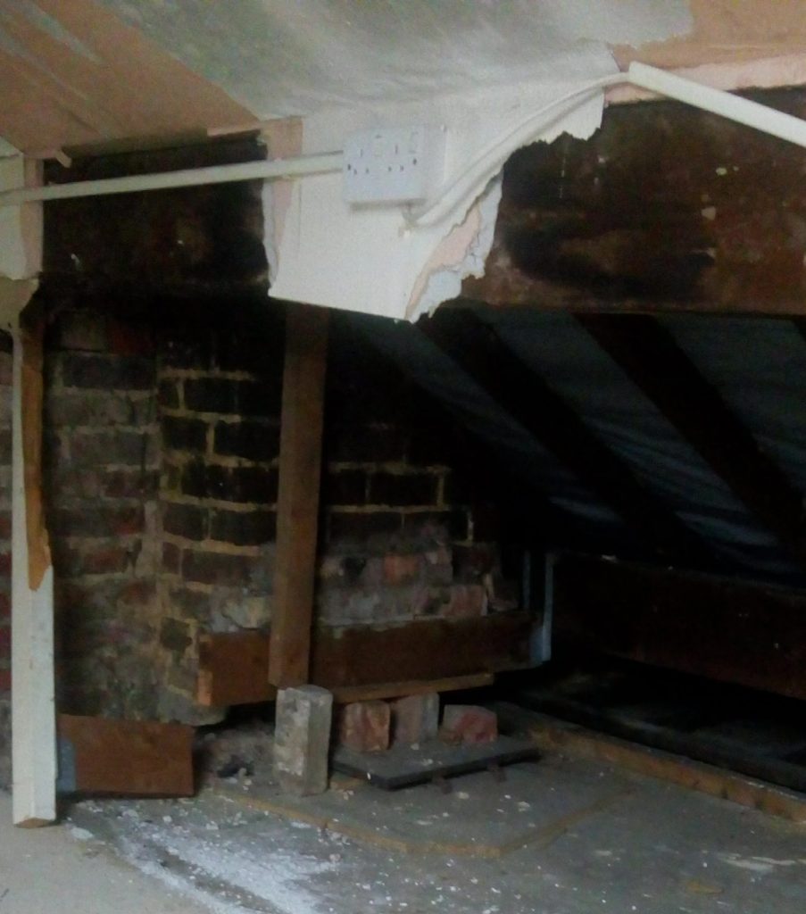

The focus on the loft started with an advisory in our building survey –  to check that the chimney stack, removed at the first floor was supported above in the loft space – which was then boarded out as an office.
Unsupported chimney stack in loft.
Breaking through boards to check the remaining chimney stack in the loft – a structural surveyor confirmed that a steel support was needed.
It was also apparent that the damp smelling loft space was lacking ventilation and was visibly trapping condensation, as shown by the large patches of black-spot on the loft wall coverings.

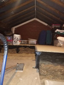

SheepWool insulation with new raised loft floor
Despite our continual wet readings, we were reassured, that while measuring humidity and the temperature of a space, the fluctuations inside will be ambient with the outside. Also changes to ventilation, draught-proofing and insulation can control and regulate humidity and temperature too.

Having crawled about for hours at a time in stifling PPE while removing the dust and rubble from the loft – laying the SheepWool in the now clean and dry space was a pleasure and a victory!
The insulation recommended thickness to achieve the building regulations U value of 0.16 with the SheepWool is 250mm of SheepWool’s comfort insulation.

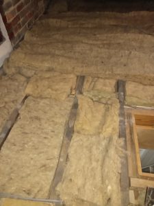

Going with the 250mm we laid two layers, laid cross-hatched achieving a U-value of 0.168.
Cross-hatched SheepWool insulation.
Being a soft and natural product, we didn’t need to wear any PPE. The product was presized to fit between our joists, and we simply rolled it out being mindful to stop at the bricks in the eaves as instructed.
